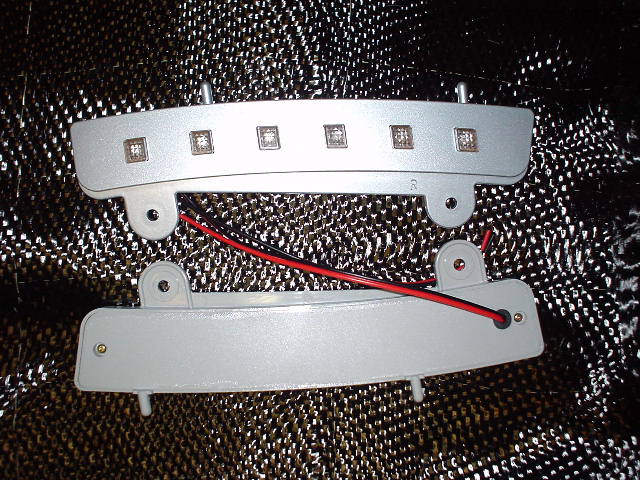

Here is a link on our website regarding Evo-R's Front Concept LED installation.
http://www.evo-r.net/product/Front_L...EPT_Z_INST.htm
