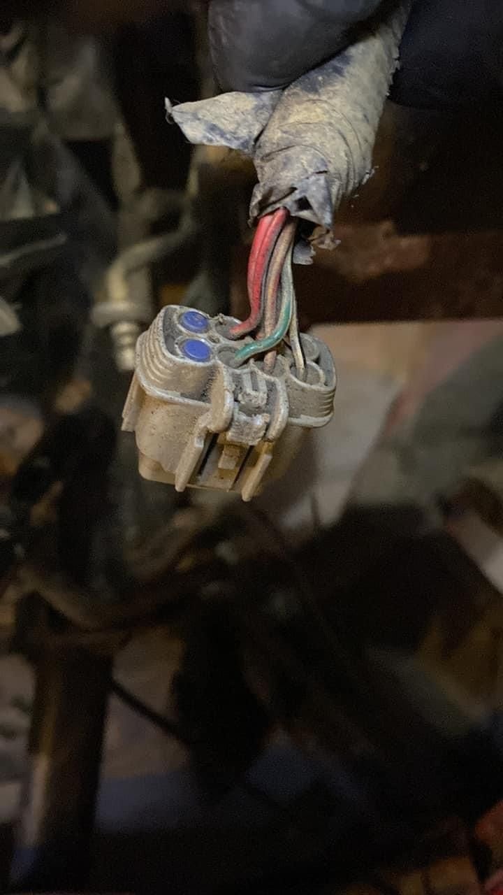

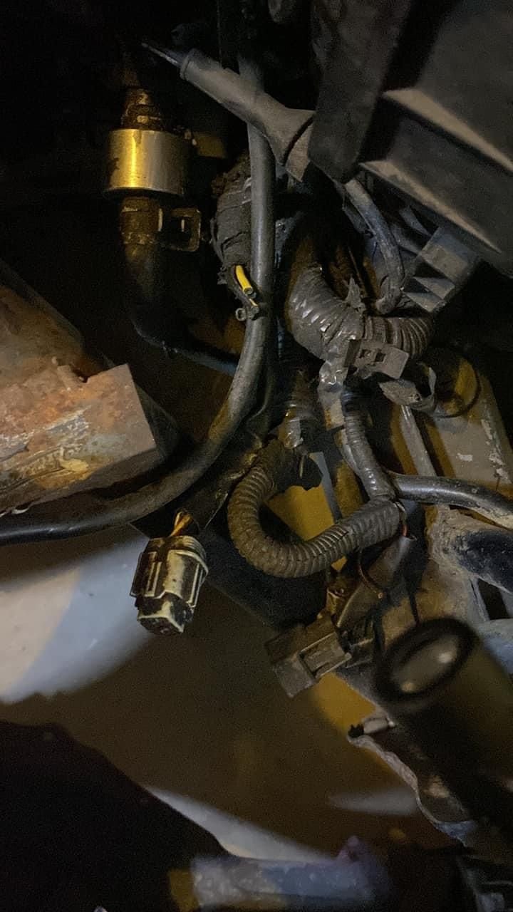

Trying to put in headlights but previous owner has modified the harness to run light bars can anyone help me find where I need to wire a new connector and tell me if the connector that’s still intact has all the necessary wires? This is a 2007 350z with the hr engine and xenon headlights
The right side which I believe is the connector.
The left side. Cant find the connector or the wires for the connector.

No idea what the previous owner did there. There should be an 8-pin male connector leading from the car/body to the headlight assembly. The first picture has two of the 8 pins plugged. Maybe some headlights with a 6-pin connector were being used? The other two wires for the plugged pins are likely buried or hidden somewhere in the wire loom.
Obviously, you need to find the other side's harness and connector. Some of the functions are bridged from the other side, but you'll still need to find the specific wires for the turn signals, otherwise they will not work properly.
What you need are some 8-pin pigtail headlight connectors. There are lots of them available on fleabay, Amazon, or Z aftermarket vendors. The wire colors will likely not match up, though.
That looks like a wiring mess. It would be a good idea to get a test light or multimeter.
Good luck.
