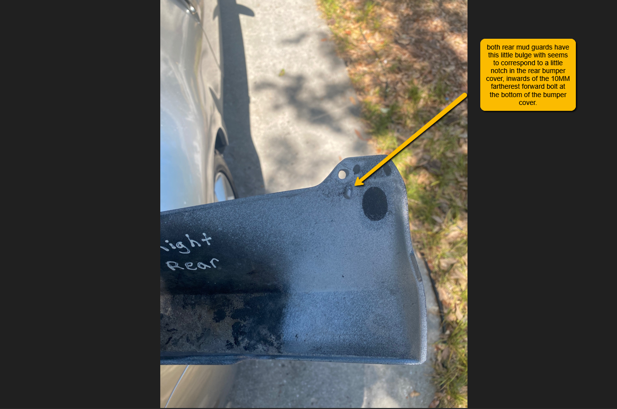

Just got my car back from being fully painted and installed new front and rear bumper covers, and sold my rear bumper cover before taking note how the guards were installed.
My new bumper doesn't have any hole drilled, obviously. I believe the there are supposed to be 2 holes in the bumper cover's lip (that you dill to make the holes) and the hole get filled with two smallish u-clips that accept a #8 truss head screw.
I believe the lower hole of the rear mud guard uses the 10MM bolt that holds the bumper cover on at the bottom.
If I had the printed instructions I could verify before I ***** nilly drill holes into my new bumper cover.
NOTE: I have the 4 u-clips and 4 truss head screws from before.

I think I got it sorted, but will still like to see the ACTUAL instructions if someone has them.
There is a notch right about here
this bulge butts up against that notch
a better look on the actual bumper cover
the mud guard placement along with expected position of the u_clip to orientate the guard. Two more holes and u-clips are needed on the front lip on the bumper cover.
