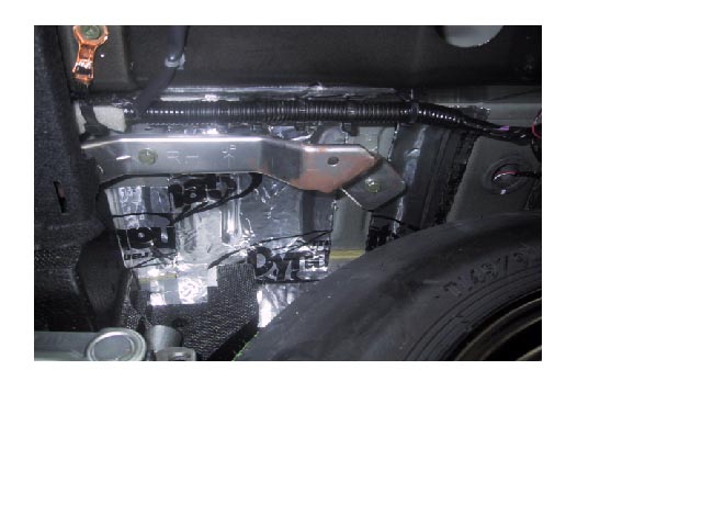

It's been bugging me since Oct. last year when I first picked up my Z.
Tried sealing the brake light switch, taking apart the rear hatch latch then lubing it, layered the whole sides of the styrofoam fillers with cloth tape, removing the rear wiper from the hatch. Took apart the whole rear plastic interior parts (added Dynamat while removed). Did not want to have someone ride in the back to troubleshoot.
Dang conduit was rubbing together at the seam so I zip tied the whole length about 1 inch appart
My wife kept telling me to take it back but being a tweaker I wanted to "do it myself".
Just wanted to share if anyone else has crickets in the rear

Thanks for the information! I was only getting it on course textured roads but now I can fix it thanks.
so it's the conduit... gonna try to rip out all the plastic and zip tie both sides...
the crickets comes and goes as it please... now I just need to make sure I kill it for sure this time...
