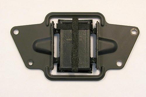

I have a track model but haven't pulled the cover to look at the "suspended" weight but I'm sure it's there based on the other posts. However, what caught my attention from the other posts is that the "ballast" is suspended. Why suspend a ballast mass - doesn't make any sense, unless ......
I'm going to throw out a potentially crazy idea on what this maybe for. For any of you mechanical/vibration engineers you'll know what I'm referring to. There's a clever vibration isolation concept called a tuned mass absorber. It works on a coupled mass principal where if you suspend a small mass on a larger vibrating mass and "tune" the small suspended mass to a specific frequency one can detune the larger vibrating mass. I wonder if the rear hatch has a natural frequency that Nissan fixed with this simple TVA. I'm guessing it's tuned to somewhere in the 20 to 50 Hz range based on the 1.5# which is getting into the lower end of the acoustic range. For the you that have removed it listen for any "acoustic" booming that you didn't notice before. I maybe all wet, but maybe not. If they needed ballast why not place it at the hatch edge where there's more leverage.

I haven't looked at the weight, but I'm hearing that it's suspended by two rubber arms on each side. Maybe that's so that, when the hatch pops open initially, the weight is supposed to continue moving upward with enough inertia and force that it pops the hatch open the rest of the way (to solve the opening problem - only it doesn't work very well).
just a thought.

I have an '03 Track and it had the weight. Here it is removed.

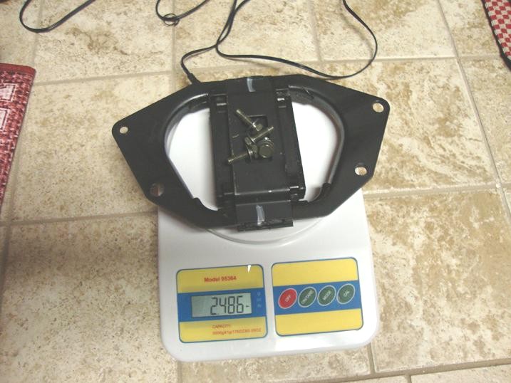

Maybe you didn't read all the posts above, but it isn't 12lbs. The only one I saw and weighed myself was less than 2lbs, but my 35th Anniv. didn't have one, probably because it came with the aero package (spoiler). And 12lbs only equals 1HP in Cambodia.

thought i would update.
my 04 touring hatch weight, came in weighing in at 2.48 lbs with screws of course.
-J
