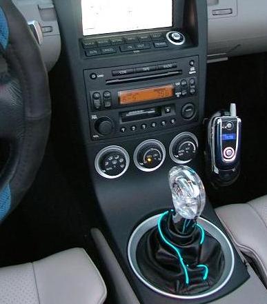

Old Jun 2, 2004 | 05:04 PM
FLZ's Avatar
FLZ
Posts: 1,055
From: Boca Raton, Florida
Default Boot Pix
just a few. Be nice people......

Old Jun 2, 2004 | 05:16 PM
silverstoneTT's Avatar
silverstoneTT
Posts: 749
From: Rockland County, NY
hows boost mobile?

Old Jun 3, 2004 | 11:10 PM
Jason@Performance's Avatar
Jason@Performance
Performance Nissan
Joined: Oct 2003
Posts: 8,783
From: So-Cal - Ready to go?
That shifter is wicked... but... straight outta TRON!
WICKED!
