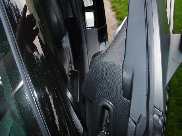

REAR SIDE
Attached Thumbnails Lambo Doors - Does anyone know about this company???-rearside.jpg

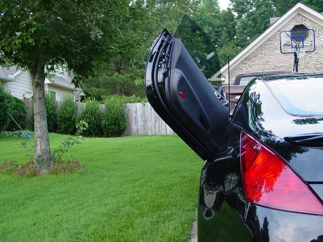

OOPS AREA (iNSIDE DOOR PANEL)
Attached Thumbnails Lambo Doors - Does anyone know about this company???-oopsmarks.jpg

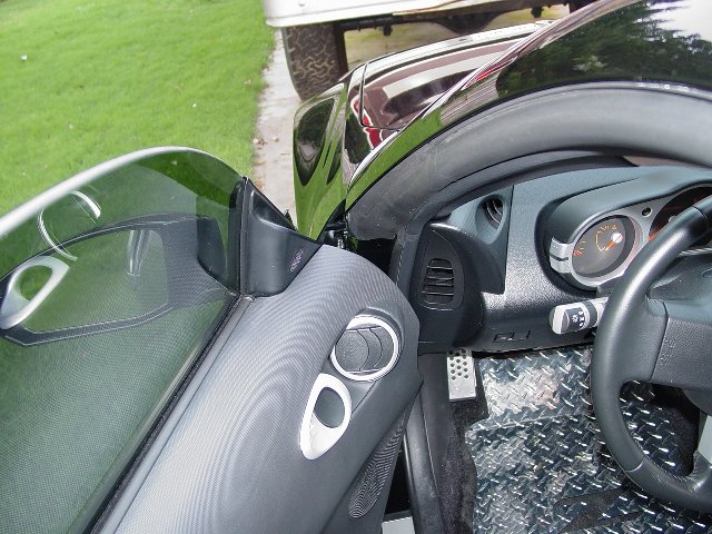

OOPS TARGET AREA #2
Attached Thumbnails Lambo Doors - Does anyone know about this company???-oopsmarktarget.jpg

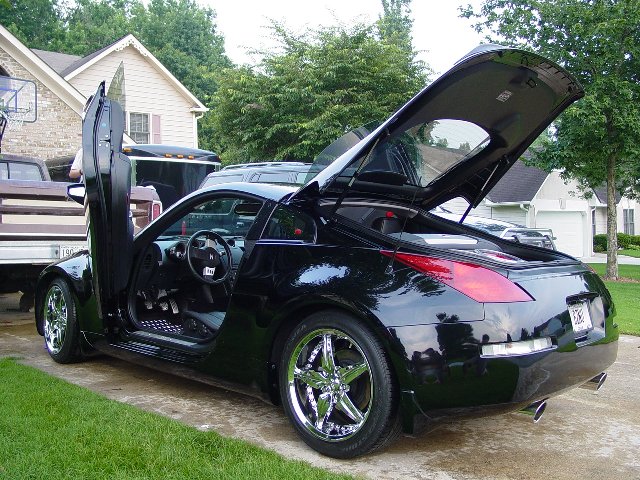

CROWD PLEASER FINNALLY
Attached Thumbnails Lambo Doors - Does anyone know about this company???-siderearshot.jpg

Thanks so much jcn! Those are really great pix and help me understand it much better.
Now, are these the VerticalDoors kit or are they something you had made up yourself? If you made them, are they patterned after the ones VerticalDoors makes?
I'm not really understanding the OOPs pic and I don't see any OOPses in your "target" oops pic. Can you clarify please.

I think what JCN is getting at if you look at the first oops pic is the crimp in the leading edge of the door panel, just above the vent hole. I think if you don't open the door to the full 25 degrees horiz. before swinging it up, the door will contact the A pillar and thus....oops.

My oops is (circled area in pic below) where I lifted the door too soon (before it was open 25 degrees) and the inside door panel hit the A-piller.

Told you about the A pillar.

So aside from this, are there any other areas that would be rubbing if and when you open the doors? Also, if you're sitting inside the vehicle is it hard to open the door vertically? Thanks for all your info concerning this mod.

JCN, is something perhaps missing in the install? I don't feel like going outside again right now...but I think when I try to lift the door prematurely, it either a) won't let me or b) slides out more while going up if the door has been opened far enough horizontally
I just went outside to attempt to hit my door against the A pillar but I think it'd be impossible without unusual force. IE I may have to break the hinge to make it extend that far.

If it is possible to describe or take a pic of, I'd like to see what prevents your install from hitting the A piller. I personally have never caused this oops. It was someone "trying it out" that did not know that you must open the door a certain amount before lifting.

jcn: I understand what you mean now, I just woke up and attempted to hit my a pillar. It WILL hit if someone tries to lift up prematurely. I 've never tried lifting it up THAT early because I can't even get in the car if I open the doors that little horizontally. Here's a pic of what I mean: http://members.***.net/stevenle/350z/apillar.jpg
So, so long as you open the door that amount you'll be fine. The picture makes it look like it's more open than it really is. I haven't had any problems yet because I tell everyone you must open out then up first and normally ppl will always open out at least as much as they need to get in okay before attempting to lift up.
