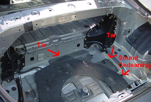

There are better ways to reduce weight, take all that tar out in the back which is to kill the sound, I took that out on my Civic which is way smaller and totalled 83lbs! I think the Z has easily 100lbs of tar... It doesn't seem so but its really thick. The only drawback is that you will really hear the rocks and just about anything on the road... The good thing is you can go buy DYNAMAT if it gets to annoying and you want to put the car back to stock... Not my cup of tea but good look with your racing, look into what I said if you really want to get on a JENNY CRAIG DIET PROGRAM

not really sure what tar are you talking about ... ?
the z, or at least the rear of it and the doors (i haven't looked under the seats or anything in the front) is pretty much void of sound deadning material.
maybe all those civic drivers with horrible sounding exhaust (no offense to other civic drivers, just the ones with rediculous exhausts) can't tell that their rides sound so bad because of the 83lbs of sound proofing?

Here is the tar in the back. I would like to get it out of my car, but it seems really stuck. The mat on top of it is some sound-deadening pad (also found in the spaces behind the seats). My Track didn't have this rear pad, but it appears the Touring does?

hmm that's weird. i just stripped everything in the back the other day to dynamat and my trunk definitely didn't have that pad and not even as much sound proofing under that pad. it also didn't have the stuff on the wheel well that you can see in the picture for the right wheel. it had like four 2x2 inch squares and that's it.
well now it has lotsa dynamat.
seems like the touring has a lot of extra useless parts...
why would you want to remove the tar ? is it really that heavy ?
what trim Z do you have ?
