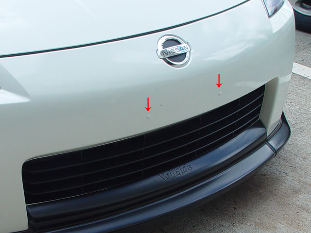

I bought some plugs from Home Depot. They cost about 30 cents or less. Its in the hardware section (where the screws, nails, etc are located). I used locking hole plugs. Just get some touch up paint and paint it to match.
Attached Thumbnails Holes in front bumper from license plate holder removal-plugs.jpg

Better yet, get nylon plugs from HD. Make sure you measure your hole diameters before you go. Like dsmal above, I used touch up paint on the surface and used a few coats at that. Then I clear-coated the plugs. They look A LOT better than the holes and cost substantially less than bumperplugs.com
The nylon plugs cost less than $2 for both. Touch-up paint varies upon source (typically $6 and up). Simple plug and play

Yep, mines are nylon also. Looks damn good hehe.

any pics with the nylons?
