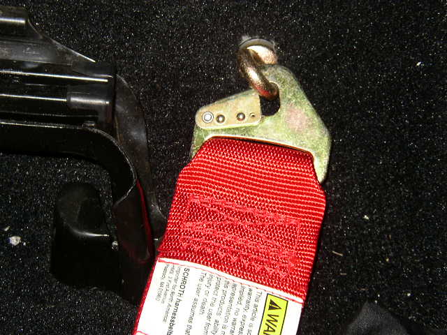

Does anyone have these with the competition harnesses. I wanted to install mine today, but the openings for the belts on both the snap in and bolt in kits i recieved seem like they fit the 2" kits. Are there different bolt in and snap in kits for the competition harnesses? Am i just supposed to "make them fit"?

Yes, "make them fit"!
I'm surprised that instructions weren't included. Just fold the belt material in half to slide through. Then when the desired length is reached, center the belt in the hole, leaving about 1/2" folded over on each side. Wish I had a picture to show what I mean, but I hope this helps.

Found this pix of my 3" Schroth:
Attached Thumbnails Sparco Bolt In & Snap In Kits-seat-belt-inner-mount-.jpg
