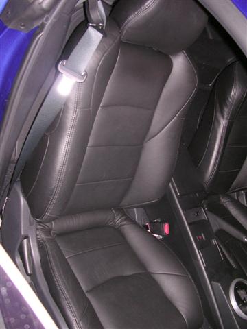

I had mine installed by a small car upholstery shop for $100. I watched two of them do the install & it takes a lot of pounding, pulling, stretching & spraying of glue. They also added a layer of extra foam to make the leather fit tight. It takes experience to make it fit right.
Attached Thumbnails How hard is it to install your own leather seats/covers?-dscn0853-small-.jpg

Unfortunately, that shop has closed awhile back. Just go to any car upholstery shop & just indicate to them that you want it reinforced with additional foam & to stretch it well so that there are no wrinkles. They will take off the seats & actually install them on top of their table pounding it to fit snuggly.
