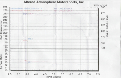

Ok guess I should start a thread seeing as this will be a first for this board and maybe even a first for HKS. Plus I can put AAM on the spot to do a great job LOL hint hint
As some of you know I had my car dynoed yesterday with nismo exhaust and the HKS SC kit. well I only put down 267 and 13.1 A/F not good and not what I was looking for. Problem seems to be a easy fix they are looking at a boost leak or belt problem. So I am going to have this fixed and also have the FCON V pro installed because I just dont like the the idea of not being able to tune the FCON S. Bad set up from HKS if you ask me. but anyway plans are to have this problem fixed and install the FCON V pro at the same time. Run a new dyno and see that the # and A/F is then.
After that I am having headers cats and plenum installed plus the AAM fuel sestem and 440cc injectors.
I will upate this thread as the progress happens. and here is my dynp from yesterday

Ok got a update now before I was only pushing .4 bars of boost. AAM needed to find out why and do a Compression test. everything is working right now I am at .6 bar at about 7k. Compression Ranges from 195 to 205 The FCON V pro is in and they are doing a few runs with that and ge that working right.

what was keeping it from the extra .2 bar? I know the stock kit is suppose to run around 7psi, but personally I'm only seeing about 4 or 5. I figure it was just my plenum and tp.
Dont really know bro. but they are guessing the car is pulling timing at higher RPM's right when I should be making peak power but its fixed now so if that was the problem I dont know. Soon as they get this FCON V up and running and all the mods added I dont think there will be any problems the FCON cant fix. Plus the fuel rails will help with a better platform to work off.

Looks like the timing issue was spark blowout. There were stock plugs in the car with stock gap. I'm suprised it was not bucking at higher rpms. That's how bad the graph looked. We always do one heat range colder and .33 to .35 gap on all FI setups. HKS actually recommends two steps colder.
