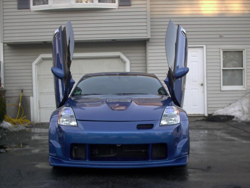

Off the topic I love your bodykit!!My car attached

Hood is the Kaminara hood. more pics attached
