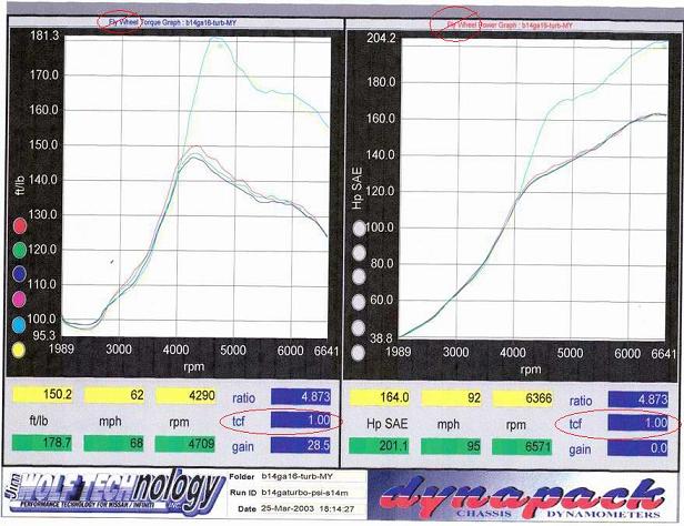

Here's a pic I found of a fairly recent Dyno Plot from JWT ... showing TCF is indeed, as I believed, sitting at 1.0 (no correction). In this case, the term 'Flywheel' (which you can't remove form the software) will have been incorrectly interpreted.
DynaPack ... if you're reading this ... please fix the damn thing!
