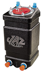

mine took a refill about every tank of gas..... so i would get gas and refill the tank.. i had a tank from Jeg's (black gas tank, mounted in the trunk, had in/out ports)
let me see if i can find the picture......

here basically like this one, but only with one out port. 3 gallons by the way
