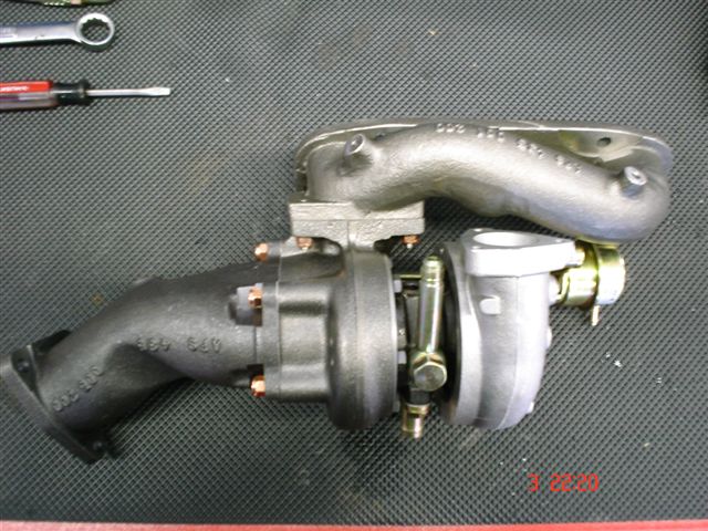

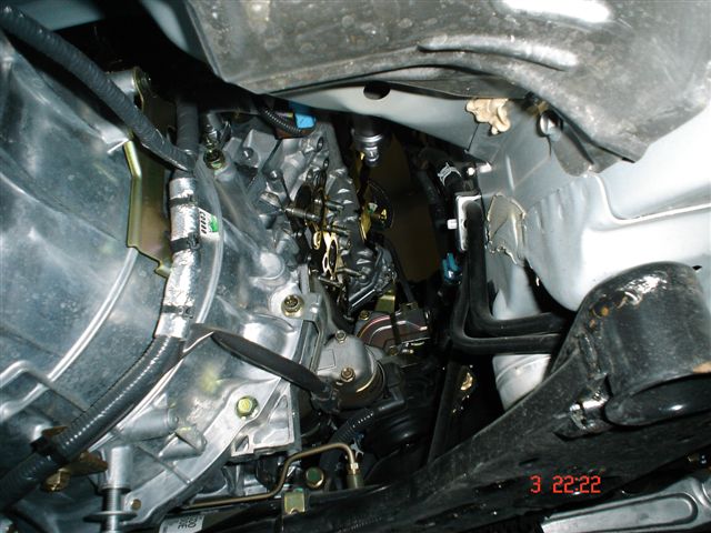

ok sorry im so late on this but i can help on the r/side install; Do not install in parts as instructed for the turbo and manifold!, asemble it as a unit on the bench, manifold turbo and down. remove the motor mount top bolt on r/side and lift engin( not to much or you will bend the uper cowl at the itake manifold) remove the small brakit ubuv r/side of trans.you will find the fule lines seem to be in the way no mater what you just have to work around them and be carefull, i have don this with and without the trans in,you may think it will not go past the starter ears but it will in fact after you have dun it a few tims it slides up in place very easy, its fast and much easyer than installing as parts. the asembaly will slide up in place from underneth with no problem. you will have to go from under neth the car to on top, back and forth to secure the exoust manifold nuts you will see what i meen when you get there.starting the farthest back nut on the manifold is best and it is not easy to get started and after you get it started only thred it a few threds(this is very important!!) then go to the top of the car and start the rest. And dont beet your self up the L/side is hard and it will not go in as an assembaly. it sounds like you did just fine. good luck and i will check in on you in a few days! sorry a bout the spelling but im in a hurry and tired.

Hmm...I already have both manifolds on and really don't wanna have to pull it off again! Plus I don't have an engine hoist on hand, so I think I'm gonna try doing it with the manifold on the car first, then if that doesn't work at all, I'll give your method a shot.
I sure wish I'd thougth of that earlier in the install! Actually I did, but didn't think it'd fit because of the motor mount being in the way.
