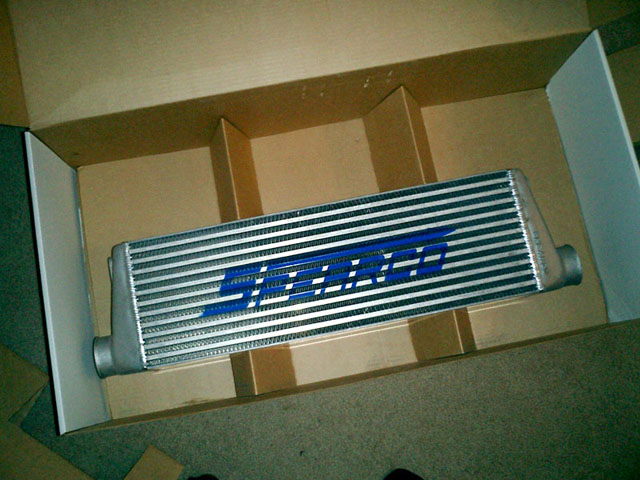

The Spearco intercooler that comes with the Turbonetics kit is definitely wider than the one that comes with the Vortech. T-netics is 24 x 7.75 x 3.5.
Is that core width ? I just did a ruff measure of mine [ Vortech ] 21" inch core , about 24 inches total

Erm, sorry. That's the core alone.

Wonder if that would fit the G35 , with out any changes ? would have to cut the intercooler pipe , maybe a custom one made to fit this cooler

Humm, so it(T-bon) is about 4" wider than vtech..
