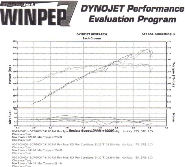

Here are my 3 highest dyno runs.
Attached Thumbnails Pix of My Vortech & Minetix Manifold Install-3-highest-dyno-runs.jpg

that looks exactly like mine with that dip at 5500

I have had the car tuned. They worked on it for about 5 hours they said. It started at around 275 HP and went up to about 343 HP. They said that they can not get any additional power out of it.
that is crazy, I have my vortech finally installed and it dynoed at 370. I only have an exhaust to add to performance stuff, and the tune is rich. At WOT I am at about 9 with my AF and can lean it out to about 11 and be good. You should take it to another shop cause you can get more out of it. Your setup looks nice, I have one of these manifolds on the way to me right now, I am excited!!! it looks hott.

Nice to see you finally got it installed. I am thinking about taking it to another tuner but I am kinda limited by money right now from the initial install and tuning costs.
