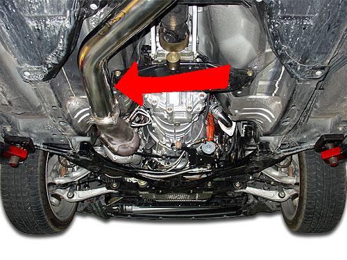

Over here too.
Does the Unichip modify the signal from the O2 sensors, and does it come pretuned for running no cat?
If not:
Will the APS cat, or a cat of my choosing fit where I have the arrow pointing so I can plug in my O2 sensors? Will they reach? Besides that, will the sensors be too hot from the turbo in this location?
I'm concerned about this stuff b/c it's been said the 05's are more picky about running no cats...
