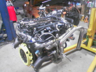

Heres an update!! Motor will be back in tomorrow... Lookin good.. Heres a scary shot for you though!!!

Have you guys tried dropping the motor/tranny as one unit from the bottom? Takes us about 1.5 hours prep time, and then 30 mins of lowering time.
Old Aug 4, 2005 | 07:49 AM
one3502nv's Avatar
one3502nv
Joined: Feb 2005
Posts: 377
From: NJ
We find no reason to drop the trans... Extra work, to remove exhaust, drive shaft, wiring, bracing, etc... Its very easy to pull it out the top. And we install the clutch on the hoist and lower the engine right back in with 90% of it together, then just reassemble the front and good to go... Takes 3 hours to pull the car in and have the motor on the stand... But everyone has there own ways to do things...
I used to pull them out the top/front....tried it out the bottom...I will never go back.
You dont have to unplug much of anything from the engine..just pull the main harness through the firewall, and rest it on the engine. It's so clean.
But like you said, everyone has their way of doing things.....do work works for you.

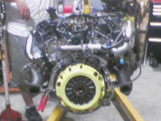

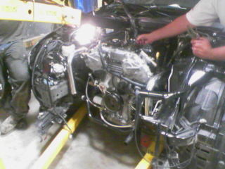

Heres a few more shots!!

Are you able to drop the motor back in with the turbocharger compressor oulet pipes attached? How tight is that fit coming from the top/front.
Old Aug 4, 2005 | 08:14 PM
one3502nv's Avatar
one3502nv
Joined: Feb 2005
Posts: 377
From: NJ
Originally Posted by Sharif@Forged
looking good.
Thats one of the main reasons we drop it in from the top!! If you have installed an APS TT, you know how hard it is to attach the discharge pipes... The motor will fit in from the top with everything attached... And its tighter than a ...... well I'm not going there!! But yes, it fits... Don't want to give away all our secrets but like I said, we don't even unbolt the trans from the car...

Originally Posted by bsp
Yeah, we don't pull the motor to do the installs. It does seem like a lot more people are doing it with the engine out. Ed hasn't seen the need to pull the engine out either though.
I am curious to see if it's a matter of just getting the install done quicker, or perhaps it's just easier?
Hi Chris,
There a couple of turbocharger exhaust flange bolts that are literally near-impossible to access with the motor in the car. Even with a cut and modified short wrench, it is a major PITA. Even with the engine on a stand, they are challenging to trq down properly.
But plenty of people have installed the APS kit with the motor in place. Since engine extraction can be done in well under 3 hours, it makes sense for many people to pull the motor out. Even the simple things like removing hose clamps and stock coolant piping, can be significantly expedited by removing the engine first.
Hope that helps.
Old Aug 4, 2005 | 10:29 PM
weslutes's Avatar
weslutes
Posts: 539
From: huntington beach CA
I pulled the motor out the top no problem,I didn't even take the front off. However re-installing the motor with the turbos looks like it's gonna be real tight.
Lookin good
Old Aug 5, 2005 | 04:32 AM
one3502nv's Avatar
one3502nv
Joined: Feb 2005
Posts: 377
From: NJ
yea, we did my car with the motor in and allthough possible, never again!!! Like Shariff said, SO MUCH EASIER with the engine on the stand and quicker.. And takes less than 3 hours to pull it out... And we find it better to remove the front of the car so we have more access to certain areas plus we can fit more on the engine when it goes in... Just got to remember to recharge the AC when done!! :-) ... As far as secrets, we made some of our own tools for the install.! Lets put it this way, a bunch of 10mm open ends , some rod, and a welder can go along way!! haha
