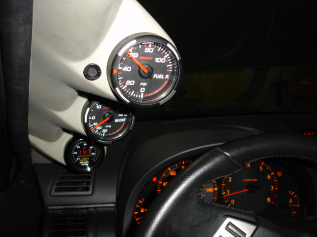

I have a AEM wideband, defi d boost and fuel pressure gauge in an a pillar. Since I didn't have space in the pillar for an EGT gauge and I don't want to hack up my car, I bought the PLX R-500 for my EGT gauge. It just so happens that I will get a second wideband and a knock amp with the PLX. I am going to have it installed in my sunglass holder.
http://www.plxdevices.com/R-500_productinfo.htm
Attached Thumbnails Gauge strategy?-fuel-pressure-gauge-boost-gauge-and-wideband-o2-sensor.jpg

I forgot about the R-500. That looks like a really good unit. I've heard from a couple local tuners that the PLX widebands seem to be more accurate than the AEM. Why do you have a fuel pressure gauge inside the car?
Old Aug 18, 2005 | 07:17 AM
Gman2004's Avatar
Gman2004
Posts: 4,328
From: Miami, FL
So I can see if I loose pressure. It might not be fast enough, but if all of a sudden I loose pressure during boost I can shut her down.

yeah, chances of happening are slim. So yes used to tune the car, and also I had a extra hole in my gauge pod. They don't make double pillars for the G. When I bought the pod, I had a vortech. If I would have had the Greddy at the time I bought the pod, I would have bought an EGT gauge instead.
