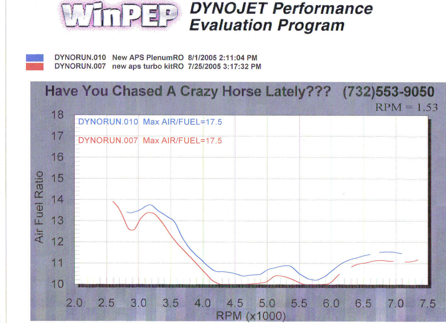

Actually here is my Before and after A/F.I am really running pretty rich and need to retune, however I was left the headroom for when I upgrade the actuators.Keep in mind Im oly producing 10 psi of boost on a lower compression motor.Ill get the HP Dyno later from my shop.

From: West Chicago, IL
thanks for the graph. as I expected, the car is running quite a bit leaner and i bet a bit of your HP came from there. HOWEVER that is not a bad thing... because after all it does prove that the APS plenum has greatly increased your airflow... this means its working well at its job, making HP, and leveling out the airflow for greater HP potential.
One thing it does prove is that the product does perform as described and it leans the A/F Throughout the RPM range as the graph indicated.It MUST be flowing more air, like you said..It definitely works the was it is engineered to work.
