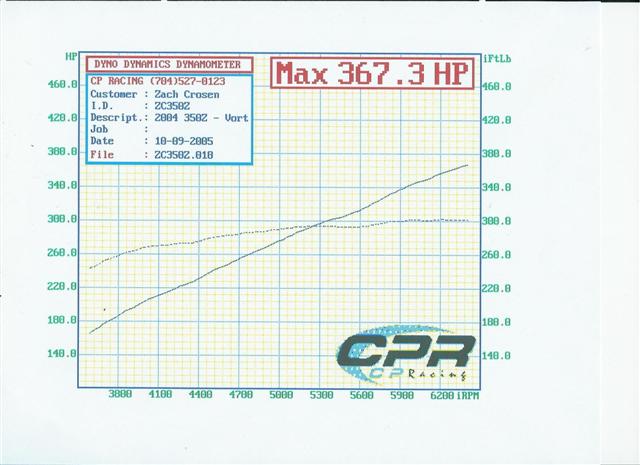

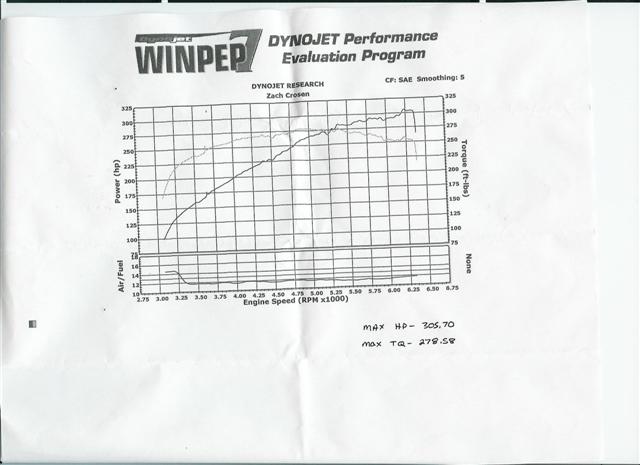

I finally took the 350 miles trip to CP Racing in Charlotte this weekend to have the 3.12 pulley installed and a retune done. Overall, I am happy with the results. Prior to my going, I had a tune of 305 RWHP and 278 RWTQ. I was also ONLY seeing about 5.5-6.0 psi of boost. This setup was tuned at Z1 Motorsports in ATL on their Dynojet dyno.
The results:

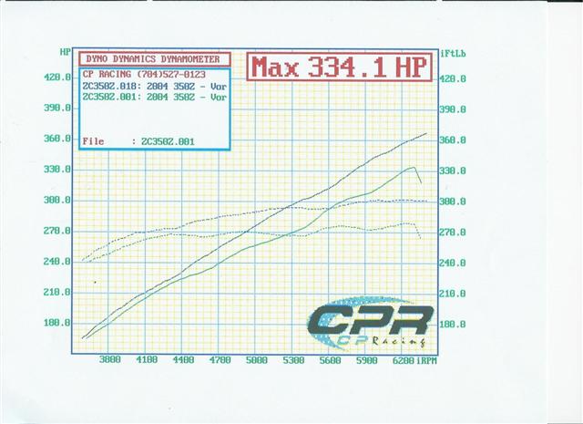

The first run after the pulley install with no tuning was 334.1 RWHP and ~285 RWTQ.
Thanks to the guys at CP Racing, they got me up to 367RWHP and 305RWTQ on their Dyno Dynamics dyno. This time, I saw boost in the 7-9 psi range. I am not really a good judge of increases in power so I cant really say for sure how much stronger/faster it feels. I do know that it did feel a little faster! As far as I am concerned, the test in my eyes of gains is at the drag strip. If I see a drop in my 1/4 mile times, I am happy.
I can post up copies of my dyno sheets if anyone is interested in seeing them.
Maybe this will help answer some of the questions that several guys had about going with the 3.12 pulley.

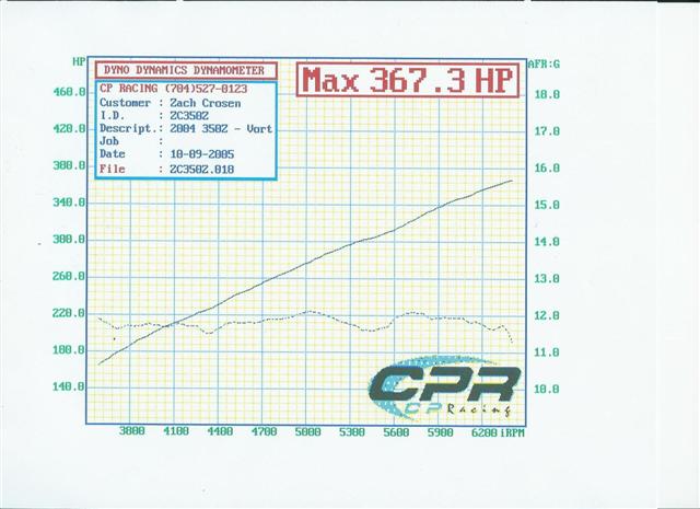

Here are my dyno sheets from this weekend and from Z1. The one from Z1 was from the final tune I got from them a few months back. I was told by CP Racing that the AFR curve is always less flat on a Dyno Dynamics dyno because it is not corrected for flatness where as the Dynojet AFR curve is corrected.

damn. you should email z1 a copy of the cp dyno so they can see with their own eyes the level of their incompetence.

Well, the Z1 tune was with the 3.33 pulley while the CP Racing tune was with the 3.12 pulley. I dont really want to start a lot of **** with Z1.

I agree about CP Racing!! Nice people and very responsive to my ton of questions! Ralph(I think that was the tuners name) did several pulls because the AFR kept cahnging from 1 run to the next and he kept tweaking it after each run. He was very meticulous to ensure that the AFRs were consistent or close to consistent from 1 run to the next. I highly recommend them to anyone.
