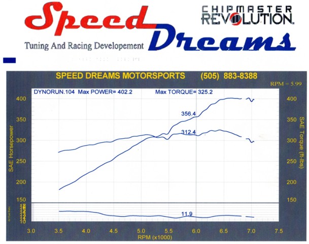

I can vouge for this. Just left SpeedDreams and got new dyno #'s. Here's my dyno sheet. I think SungNamZ got the extra power from going with bigger injectors. I'm happy with this for now. Thanks Ryan @ SpeedDreams!
Attached Thumbnails Kinetix SSV dynoed - N/A-dyno-sheet-402whp.jpg

What were your original numbers? IMHO your post is worthless without them. Maybe I don't understand your post totally. I apologize if so.

Lets not forget sungnamz's car also had a raised rev limiter and most of his hp gain was 6k - 7k. Most people with FI didn't raise theirs.

Well, for what its worth the sheet shows a good pull from 6krpms - 6600rpms after that it levels off. So the extra 400 rpms did nothing more.
