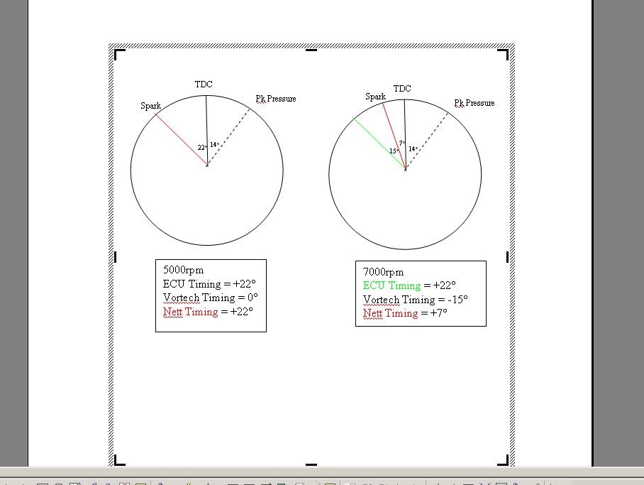

Surely you do want to be reducing timing advance as boost rises because at higher pressure and temperature in the combustion chamber, detonation (burning of the end gas well after normal burn, after peak cylinder pressure) will be more likely to occur. So you reduce timing advance to reduce this tendency.

I didn't quite understand your statement. You need to retard the timing as trq peak approaches, and then slowly advance the timing towards redline.
I must've misunderstood what earlier posts were saying - so to clarify, I agree with your statement above 100%.
The attached is roughly what I think the Vortech does - please contradict me or advise, if it does do this, why this is incorrect - I think it is the correct thing to do to minimise detonation at high boost.
I'm happy to pull the diagram and leave it with the first sentence if I'm wrong
Sharif
I understand why this would be best for a turbo set up [ boost is stable and holding to redline ] Would you take the same approach in a SC set up , when boost keeps rising to redline ?
Yes I would...but a slightly different slope. Timiing should follow the trq curve. I have noticed that the SC's tend to produce flatter trq curves towards redline, so I wouldnt advanced as quickly as I would with a TT setup and a rapidly dropping trq curve. But there still needs to be some advance towards redline, for the engine to operate correctly.
