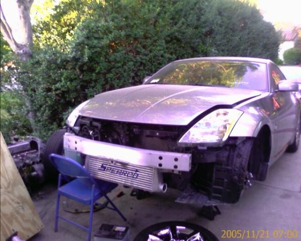

Some Pics from the install Day 1 Saturday. After Shaggy and I installed Injectors,intercooler, and totally didnt follow the directions b/c we thought we could do it easier on the power stearing cooler instead of routing it to the side of the car. we should be done tomarrow we just messed around today
Attached Thumbnails Going to Turbonetics to pickup my Z Kit today-small1.jpg   Going to Turbonetics to pickup my Z Kit today-small2.jpg   Going to Turbonetics to pickup my Z Kit today-small3.jpg   Going to Turbonetics to pickup my Z Kit today-small4.jpg

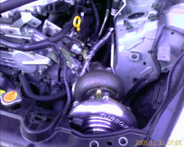

Some more....
Attached Thumbnails Going to Turbonetics to pickup my Z Kit today-t520051121074720342.jpg   Going to Turbonetics to pickup my Z Kit today-t520051121074704861.jpg

Gosh i love this kit. I'm so going to get my hands on this or the Greddy.
Do you have the option of not wanting that huge spearco logo on the IC?

From: Performance LAND
there is one thing i hate about the system. the wastegate location and mount is terrible. it almost hits the frame of the car, im worried the movement of the motor might make the gate hit
Yah just turn the intercooler around. also its very hard to see the intercooler on stock bumper
Agreed with the location, though mine along with pics that I have seen of others... Do not show any real issue with being able to move as much to kit something.
