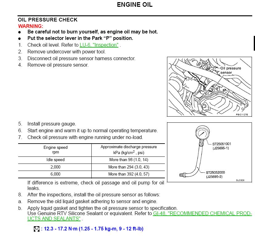

From the Service Manual (see below) and from a not-very scientific test carried out a while back (thread was about switch to synthetic from mineral)
Oil psi for factory fill mineral oil (10W-30 ?) in Blue. After changing to full synthetic 0W-30 in Red.
Engine cold
@ Idle 90 / 90
@ 40mph in 5th 90 / 90
Normal engine temp
@ Idle 20-25 / 25-30
@ 40mph in 5th 60 / 60
@ 60mph in 6th 55 / 55

You mention something very interesting that concerns me. You said you added 1 quart of oil and it increased your pressure. Oil level should not really effect oil pressue. The pickup is either picking up oil or not, pressure should not change. It sounds like the pressue my have go up do to the reduced temp of the new oil going in or some other factor. After adding oil and driving a while, did the pressure go back down to those low readings?
