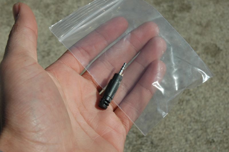

Originally Posted by chimmike
If I can get a pic of it i can figure out if i have it or misplaced it.
Yeah Sharif, this is Mike in FL. The box was freshly sealed when I got it...so it's definitely not an issue on your part......I'll have to dig around maybe, see if we can find it......or see if we can figure out how to use it without it.
Here is a pic. It comes in a little bag, so it might be easy to overlook. Radio Shack might even have them.

Originally Posted by ken350z
You could just go radio shack and get a plug. Just short the tip and ring together.
Ken'
schprekenze english?
If you could explain this a lil better I'll just do it on my lunch break, haha.
get a stereo plug, cut the wires, and loop 'em maybe? so that the + goes into the - essentially?

shoot, I'm sure I could do something like that from radio shack.

I got it. And the wideband works GREAT! Very easy to read when really romping on it
It's just a stereo plug with three connections, gnd, left, and right, OR gnd, tip, and ring. (I don't know if there is a standard for which channel goes on the tip).
Leave the gnd unwired, and short the tip and ring together with wire and solder. It's explained at the Innovative forum.
