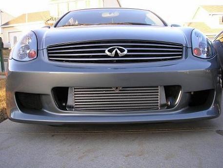

couple of pic of the IC and bumper . Car is dirty as hell , hasnt been washed all winter
Attached Thumbnails Up and running  Woooo  Hooooo-ic2.jpg   Up and running  Woooo  Hooooo-car.jpg
