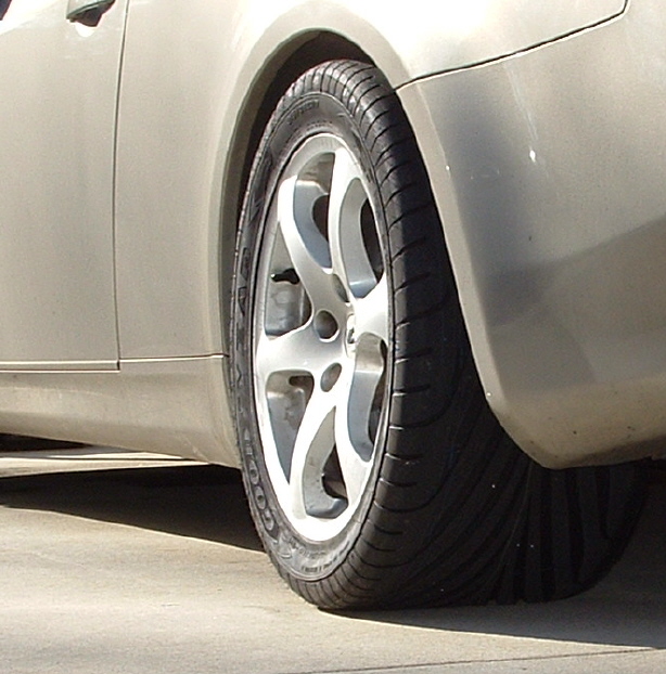

i had my stock 17in X 8in wide rims widened to 10 & 3/8 in.
plus I have a set of 25mm H&R spacers.
dont remember the 2003 17in rims offsets?
just need to know that & caculate in the 25mm
ps: sorry to get this thread off track alittle
