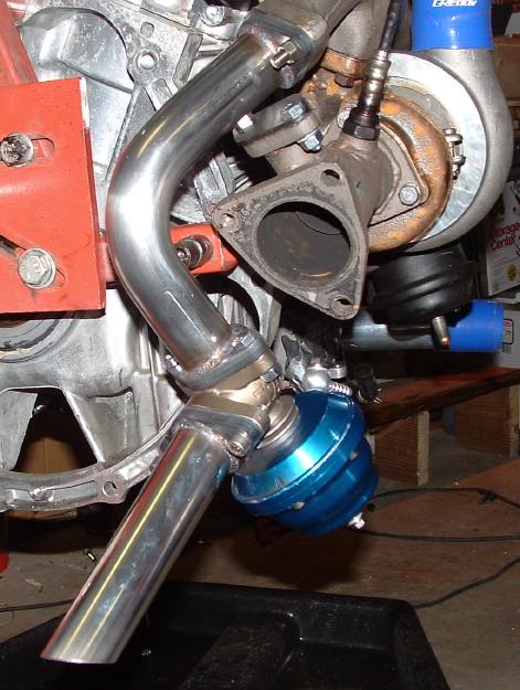

ok, I have the engine out, installing the turbo's, etc. but,
when I try to install the a/f sensor, on the drivers side, it seems to touch or come VERY close to the exhaust manifold??
any help???
Attached Thumbnails greddy TT instal help/question-builtengine-008.jpg
any help???
difficult to see in the pic, and i dont remember unless im looking at my car..but isnt the o2 sensor supposed to come in from the outside..is that downpipe on the wrong way? or on the wrong side?

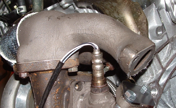

we quadrupled checked...put both on each side, rotated, double checked the turbo's, etc
the passangers side is perfect
Attached Thumbnails greddy TT instal help/question-wasterelocate.jpg

i just checked through my entire library of pics, none of them showed the 02 sensors in the downpipes, sorry
i'll keep looking

i just saw a couple of other pics on the web & some how it looks like the bung on that pipe is welded over closer to the top than most?
as opposed to being off to the side
