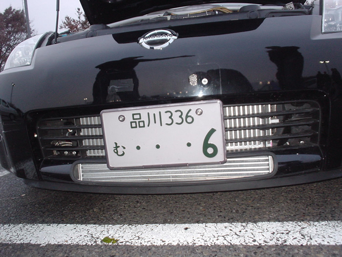

The ARC cooler fits...
I saw one on an APS TT at Fuji Speedway, for the Nismo Festival, the lower lip to the front bumper was cut out and the cooler mounted behind.

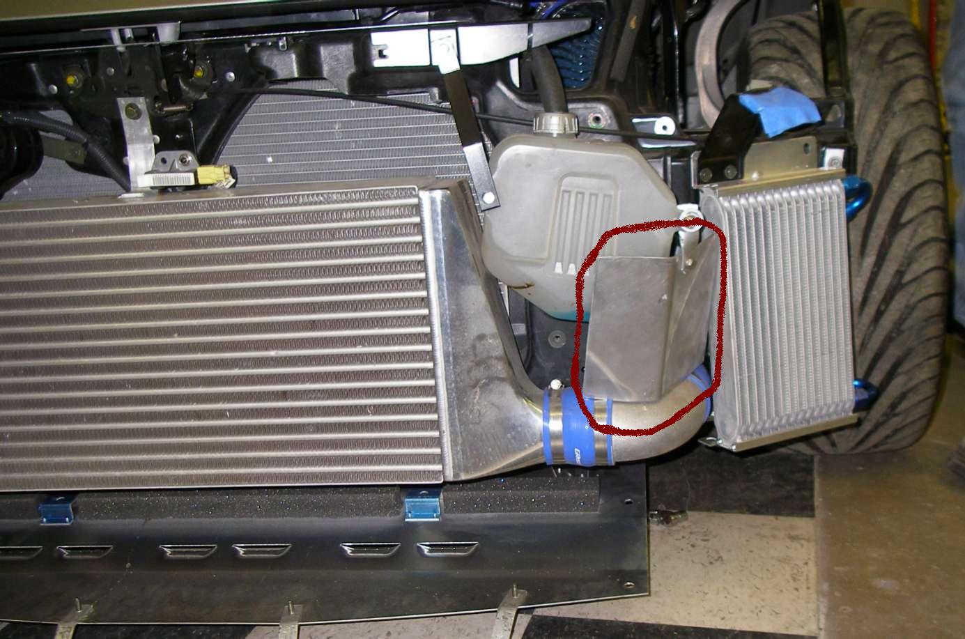

I agree. We built one using a fluidyne cooler and mounted it on the passenger side of the front bumper, and created some ducting/diverters in the bumper to make sure enough air gets in there.. Appears to work well for me.

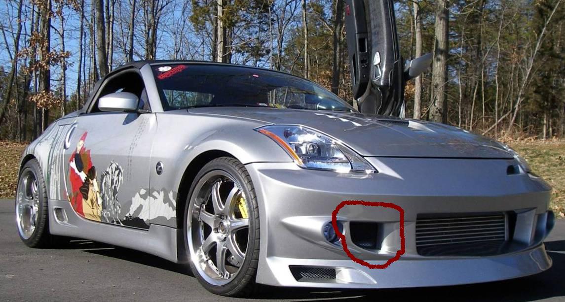

I have the Visage Type A front bumper so I have a few extra holes on the sides of the main intercooler scoop.
In the pic, the areas on each side, have aluminum diverters to push that air into the coolers on the left (oil cooler) and right (power steering) sides of the bumper. They might not look like much, but positioned right behind the open scoops and fastened to the bumper and they force the air over the fluidyne cooler.
--B

Here's the ARC one, now I have access to my piccies
