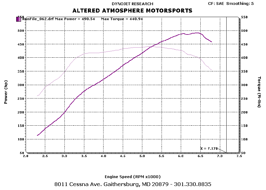

Here is mine...

It seems like everyones getting full boost at 3500 rpm, where the tq curve hits.

Yea, I was told (and my ears and butt dyno agree) that I start building boost around 2700 and reach max spool around 3500 rpms.

Kind of off topic, but I was just noticing how similiar these compare to single turbo setups I've seen. Not trying to start anything, but just noting how little lag there really is...

Well, that is one of the things I like about this setup, it has very little lag in my opinion. I am looking at upgrading the turbos (once we max these out with the new built engine) and I keep running into the problem of trying to get more power with minimal increase in my lag time. I am willing to maybe like a max boost at 3750, but I really don't want to go any more then that as it loses its street use in my opinion.
