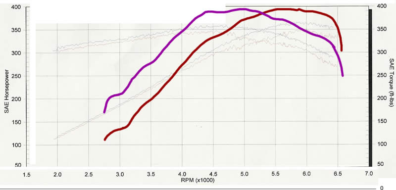

you should win
especially if you have a tilton clutch, that negates the weight added by the touring model
the C6 doesn't really have "better gearing" just different gearing. It's setup to have a weaker 1st gear because a big V8 has so much low end torque you don't need a strong 1st gear.
however from a roll it's a little bit different story. At 40mph, you'll be in 2nd gear at around 4100 rpms. He'll be in 1st gear at 5100 rpms. He'll be higher up in the powerband making a lot more power and your 2nd gear will actually be roughly 20% weaker than the C6's 1st gear when you mulitply it all out thru the final drive. But as soon as he shifts and you get higher up thru your 2nd gear, you'll catch up, then eventually pass him. You will have to shift fast though
When the C6 shifts, its rpms drop to 4500 almost everytime aside from shifting into 6th gear. Though when you shift, you'll be at around 4600, then roughly 5200 after that, and making better use of your powerband because the Z's gear ratios are closer together than the C6
so I think he'll get the jump, then you'll slowly start walking him until you're about 3-6 lengths ahead of him at 140mph. The Z's gearing LOVES 100+mph and maxes out at 187mph. Where the C6's gearing is stretched out to cover what would be 266mph, though it does have a little less shifting, but like I said, when it does shift, the rpms drop to 4500 when you'll be at 5200 (from 4th gear onward) if you shift at redline. However the C6 is more aerodynamic and it's engine is a monster at higher speeds
here's a rough dynograph of a C6 vs what your TN dyno probably looks like in dynojet numbers
thick is TN
lighter graph is C6
this should be an interesting race though that really tests the abilities of the cars and puts less attention on the launch technique and tire grip at launch

You forgot about the 400lb block he is pulling, wind factor, and C6 has a 195mph+ top end. C6 gearing is better meaning he does not have to shift as much as the Z does. He could take 4th gear to 130mph if he wanted.
