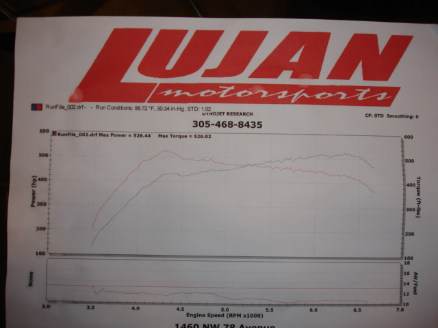

I forgot to post the dyno chart the other day. Here it is.
Attached Thumbnails Dyno Dynamics vs Dyno Jet comparison-dyno-jet-graph-001.jpg

Cool, thanks for posting that - do you have any runs starting from a lower RPM like 2000rpm so you can see where the turbos start to spool? From this chart it looks like about 3500rpm but hard to tell where the pull started. What turbos are you running, the TDO5H-18G? How much boost?
I just ordered JWT's manifolds but haven't bought the turbos...yet.

+1 was gonna say they started it kinda late...

Nice flar trq curve..yummie. Alberto..thats an awesome new avatar.

Sure...from 4000RPM on up. How often is a street car above 4000rpm unless you're racing - hence my earlier post about a run that has lower RPM numbers. Have you seen JWT's dyno chart? 380ft-lbs at 2250RPM (what's your RPM@60mph - probably about that yeah?)
http://tinyurl.com/pfyv3
FWIW: Not intended as a slam because that's a monster HP number in any case - I sure wouldn't mind 500+RWHP, that's for sure.

Sounds like a slam to me! IMO, most street cars ARE above 4000 rpm when you get on it if you're in the right gear. Are you normally @ 2000 rpm in 5th when you decide to hit it??

Thanks And yes that TQ curve is a wonderful thing, car must be loads of fun to drive with all that power. One day I may make it to that level

OK you have a point, for most street battles (Oops I mean dragstrip work ) you are in the RPM range of max power so yeah thet power will kick *** almost everywhere!
If you're autocrossing there are many situations where you want torque below 4000RPM - you can get a much faster time if you can leave the car in one gear for the entire run. For track days it's also beneficial to have a broad torque curve but GMan's torque curve is broad enough above 4K that it's likely not an issue.
Sorry, my bias toward a flexible powerplant came though. In addition to my fast car I also drive an early SE-R and it's a real bummer to *have* to downshift 2 gears just to get reasonable acceleration.

Dave, with the load based DynoPak in the example you mentioned, it is very easy to load the engine, create lots of boost, and then release the dyno. This results in a huge trq increase down low, but is not a realistic representation of the true trq the engine is making at a given point. On an inertia dyno, such as the one Gman used, the trq will build in a natural fashion...just as it would on the road.
There are lots of ways to make dyno charts look better.....preloading boost is just one example.
