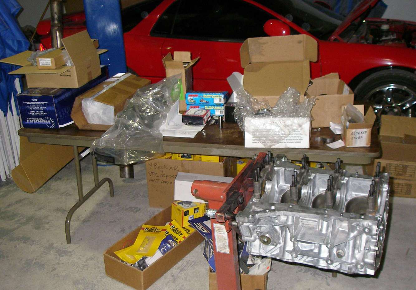

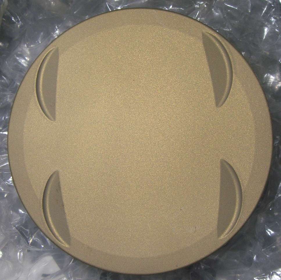

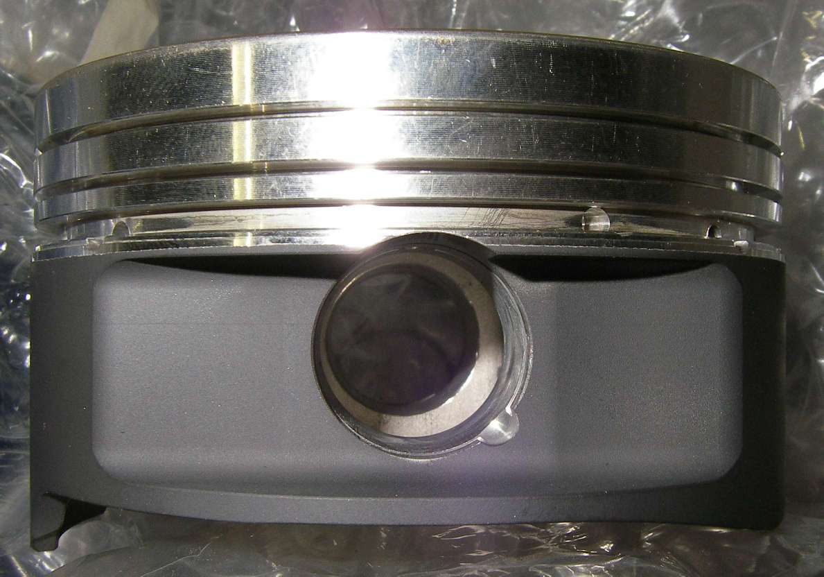

Attached are some of the pics of the parts (somewhat assembled), the Darton sleeved block on the engine stand and SwainTech coated pistons. I will post more each weekend when I can check on progress. I expect to have this done by Sep 9th for Formula D in NJ, and NOPI Nationals September 16 – 17th

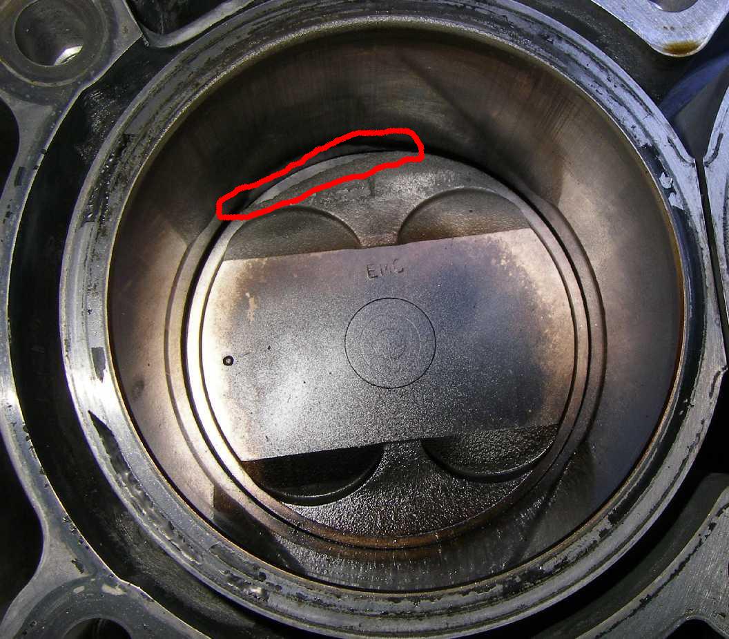

OK, as most already know I did some serious damage to the engine on the trip out to Vegas. Running 89 octane at altitude and under boost was just too much for it to handle. I firmly believe that if I had not been running crappy gas, this would not have happened. Mike’s tune from AAM was running very smoothly and I have not only raced the car on the ¼ a couple of different times, but also driven the car on a # of multi-day trips up and down the East Coast with no problems on this tune AND boost level.
After taking the engine apart, 5 of the six pistons have extreme damage to the ringlands. As you can see here, there are chunks missing from 4 of the pistons and 2 of the cylinder walls have some extensive scouring that we are not sure can be repaired. There were metal shavings throughout the block, all the oil passages and the IC piping. All the piping has to be removed, washed/cleaned to remove all the excess oil and metal shavings.
You can also notice the discoloration to the engine bay, which was caused by a lose wastegate.
I am definitely glad I have been building this new block for some time now so I can have the car back up and running. After this is done, I might even start planning a replacement block for this one (just in case something terrible happens again). Learn from my experience, don’t run anything but 93. If you have to carry some race gas or a lot of Torco octane booster in the car for emergencies.
