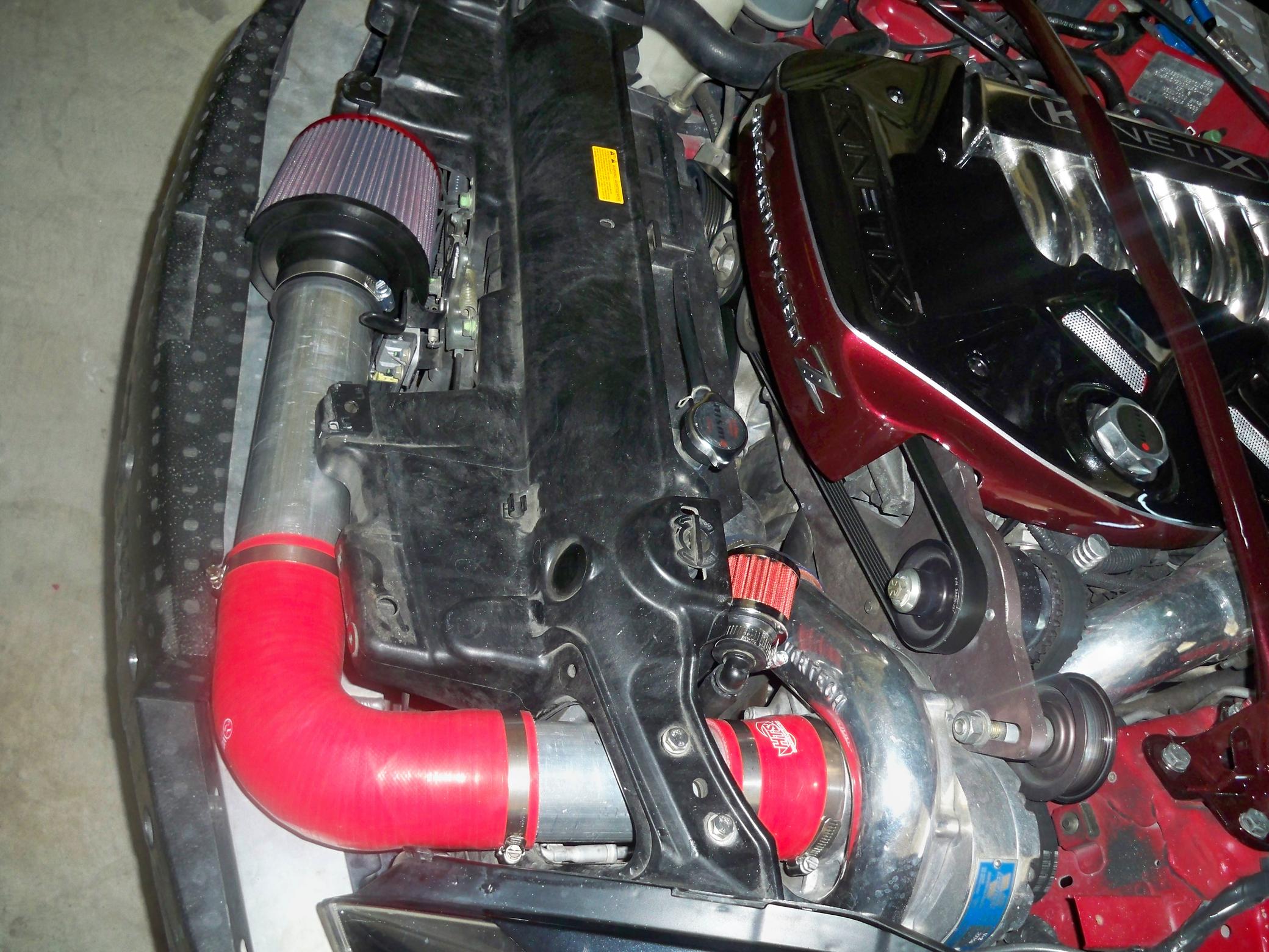

PM a address and I will send a pick of what I did

Let me know if u got the pics---I believe in simplicity---If u can , Post the pics --Im dial up so I cant

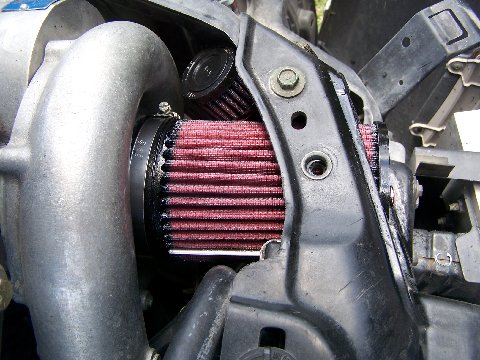

Here they are. Where can I find a link to the Varis air duct?
Attached Thumbnails Vortech Filter Relocation-filter1.jpg   Vortech Filter Relocation-filter2.jpg

Those pics are my car --as I told DMK ---K@N makes a small filter 1,5 dia and 2.0 tall with a fitting for the hose and I vented to the atmosphere---Why suck the Crankcase fumes back thru ur TB and SC---Thats the PCVs job

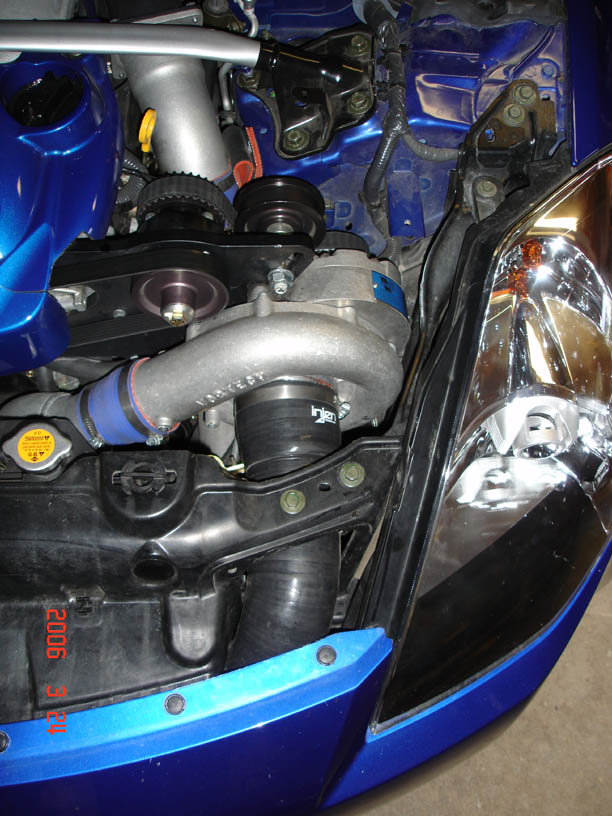

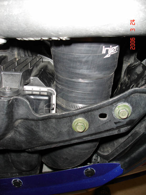

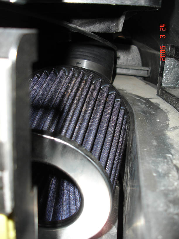

It's really easy to do. I cut up my old Injen CAI and fitted it nicely back together using the aluminium pipe at the joints. Here are a few pics.
Attached Thumbnails Vortech Filter Relocation-in1.jpg   Vortech Filter Relocation-in2.jpg   Vortech Filter Relocation-in3.jpg

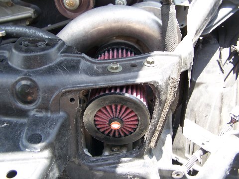

I decided not to relocate my filter. And just got another filter from Vortech. Vortech is using a different filter so you can get the filter in and out easily. And I got a K&N crank case filter for the hose that connects to the filter. I have posted some pics for your viewing pleasure below.

Post #5 are pics of my car roughed in, as you can see, as opposed to the stock Vortec filter, there is an open filtration element at the end of the filter. There is MUCH more sq. in of surface filtration than the stock Vort. filter.
A Varis intake and bottom shield would reduce temps of intake air.
I have 6" of Red Silicon inlet tube somewhere.
I made the mod mainly to ease filter removal for cleaning----It performed well

I have a question if someone could answer. I see that someone has added a small filter to the crank line? Looks like a good idea, but was'nt it hooked up to the main filter to get tremendous amount of suction from the supercharger. Now that it has it's own filter, it's not being forced through the power of the supercharger like it was designed. Confused, as i'm sure you are now? But is it going to make a difference not running through the main filter?

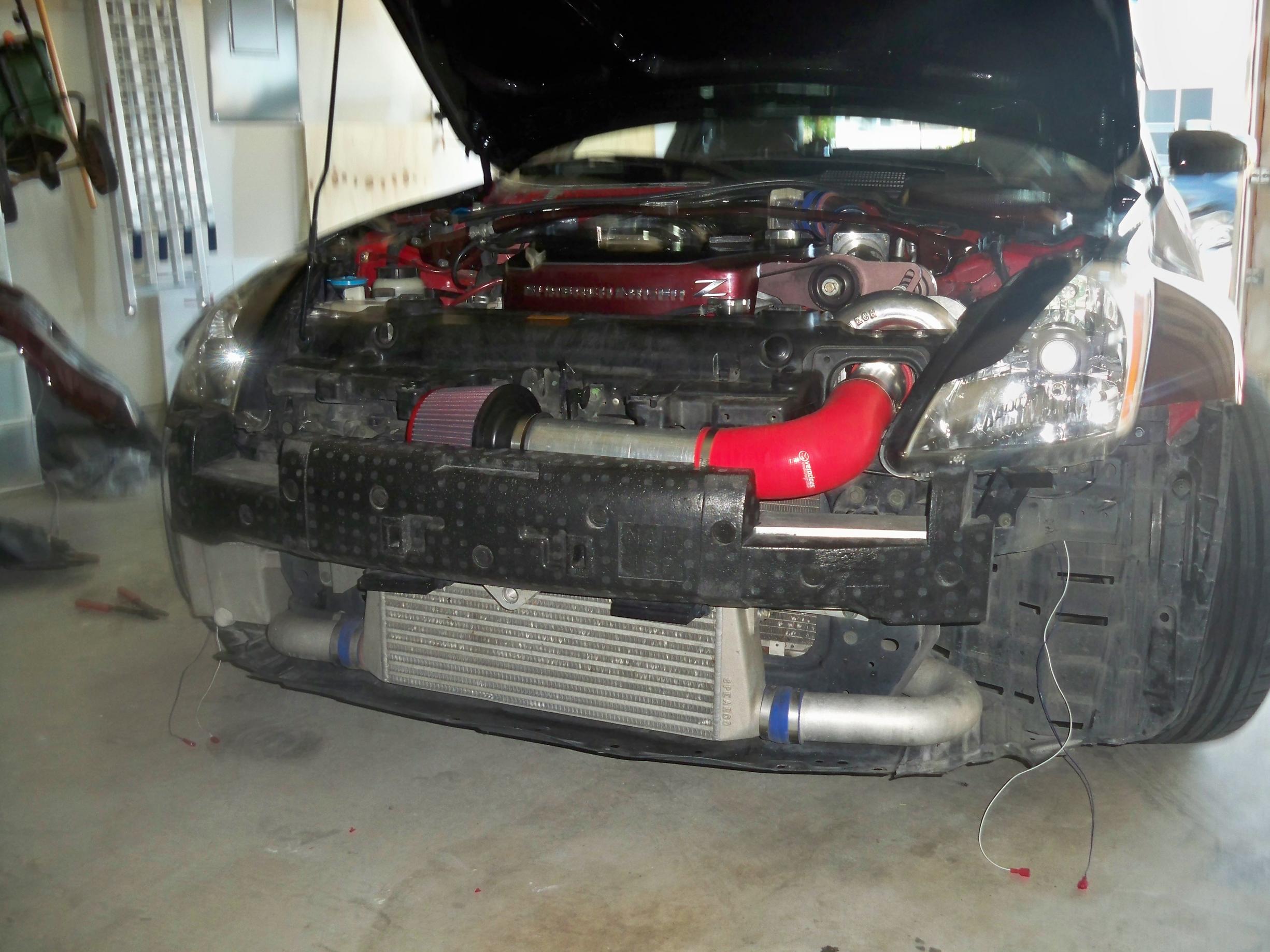

my version
Attached Thumbnails Vortech Filter Relocation-101_0265.jpg   Vortech Filter Relocation-101_0267.jpg

if u have all that room just get the longest air K&N filter u can find bc the more air the better.

I did the Mod--My car. Smaller filter is intake from ambient air as opposed to intake air.. Green is cool but performance is cooler
