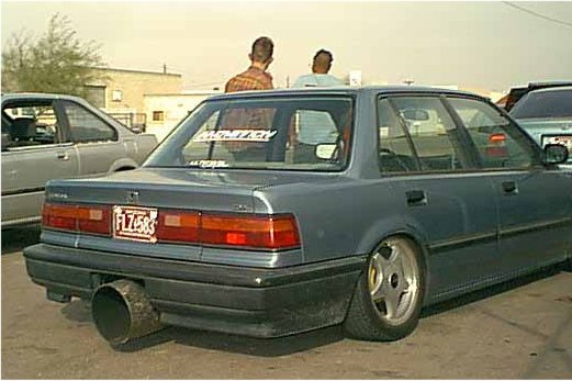

Go ahead and laugh mr ricer,
LOL...
Hey just because this is my car does not make me a ricer
