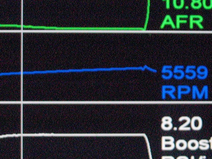

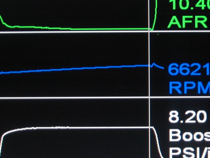

here is a text file of 4th gear during a run, the zeitronix wont let you save it as a jpeg so im gonna have to take a pic with my dig camera. side note, for some reason my EGTs have gone down a bit, must be the drop in turbulence in the downpipe with the divider in there.

in the above post, i was gonna show the whole gear, but you can only post 10000 in one post, and it was 22000, so i narrowed it down from about 6000 rpms up to redline. the boost holds from 8.1 to 8.1 at 6800.

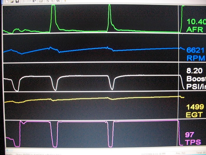

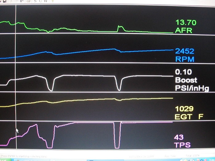

here are some pics of the datalogs. the first 2 are of the text file i posted earlier, the 3rd is a 4 gear pull, and the last is showing where i start building boost, its somewhere around 2300 iirc. look at that flat line!
