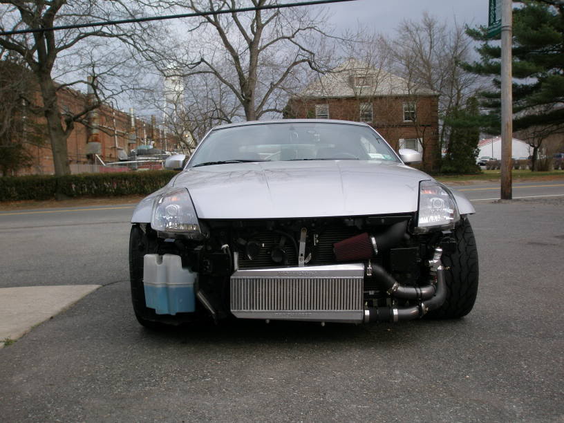

Ep3's Avatar
Ep3
Posts: 862
From: Yonkers NY
.. i know same old lame pics but they keep askin the same questions
