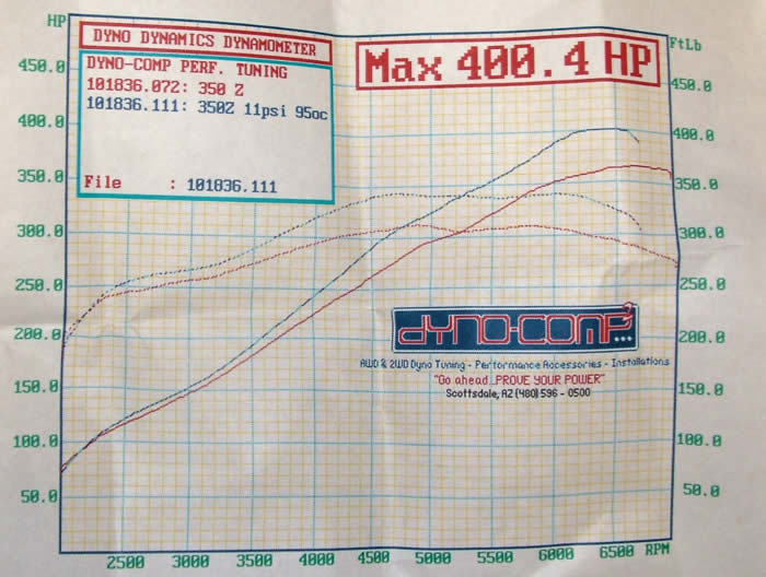

going from the 3.12 to the 2.87, I gained about 34whp and 30 tq with dynos being about 2 weeks apart - this dyno is attached

here's one of my 420whp dynos when the engine was warmed up. The midrange is way huger than my old 400whp dyno

yeah you can see my tq drop and hp level out in the upper rpms starting at 5500 rpms where the boost stops rising.
you're probably right - good catch
not sure why me or my shop didn't think of it. I kept thinking it was weird, but for some reason we all didn't even think about the belt slipping
I'll see what I can do. The worse thing that'll happen if I leave it as it is will be the belt will wear out faster
370 tq at 6300 rpms equals 444whp on my shop's dyno

Ok Sentry, here is my Dyno at 380 w/ 3.12 pulley... I am also ataching pics of the Reichard Racing pulley.
