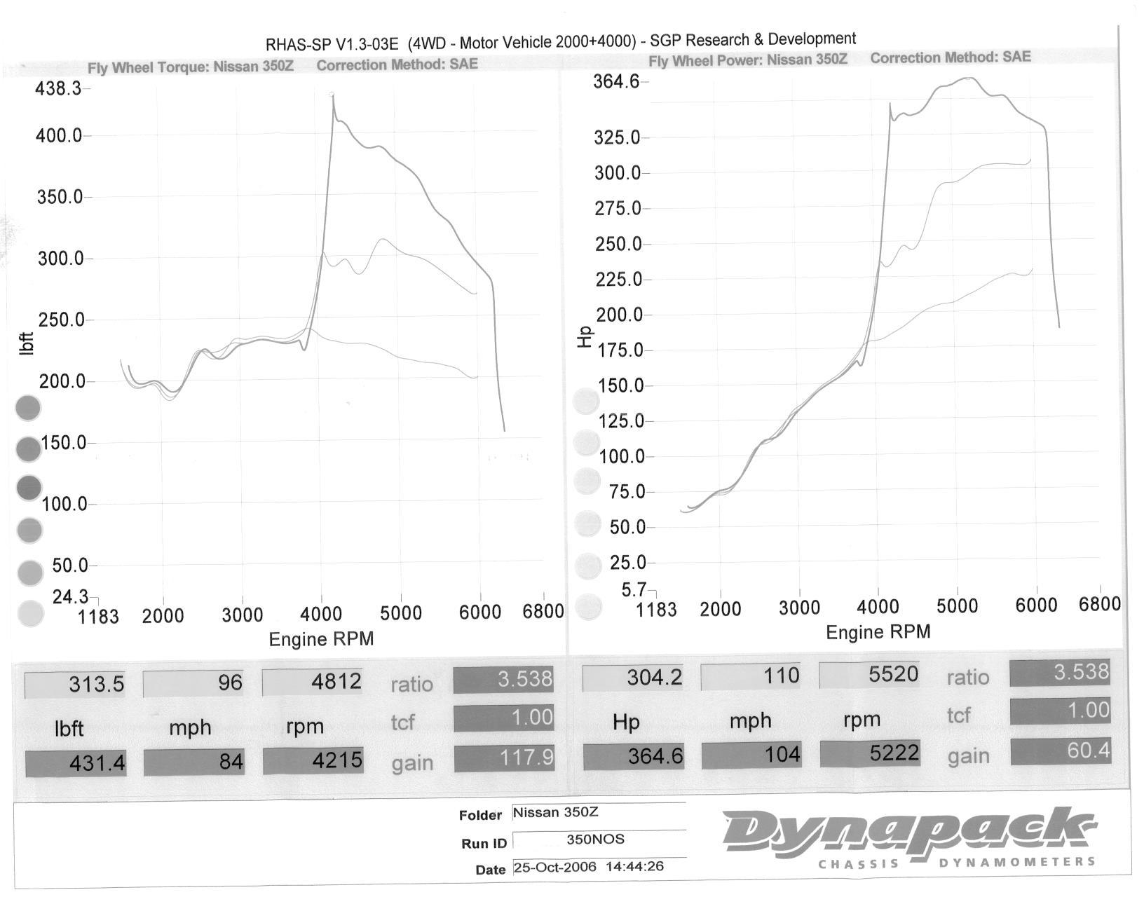

Here's mine. I'm not turbo...but I am squeezing 150 shot of nitrous on a stock block. 364whp/438wtq
