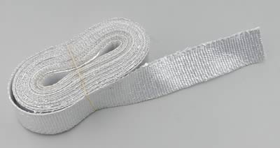

EDIT.. I apologize if they are the same thing.. heat wrap and thermo tec.. I am so green to this.. I am trying to research as much as I can before this installation.. Doe sthe thermo tec go with the heat wrap.. I am going ot get some wrap from Sharif as soon as he gets back to me..

I buy from summit. I also tried the similar stuff from heatshieldproducts.com, but I like the Thermo-Tec ThermoShield Ultra better. This stuff is for rejecting or protecting things from heat.
Lasting heat protection.
Thermo-Shield Ultra aluminized adhesive-backed tape is great for wrapping the hoses and wires you don't want to remove. It can also be wrapped around odd-shaped components for lasting heat protection. Wrap it around a fuel line and say goodbye to vapor lock. It reflects radiant heat up to 2,000 degrees F, and is twice as thick as the original Thermo-Shield.
