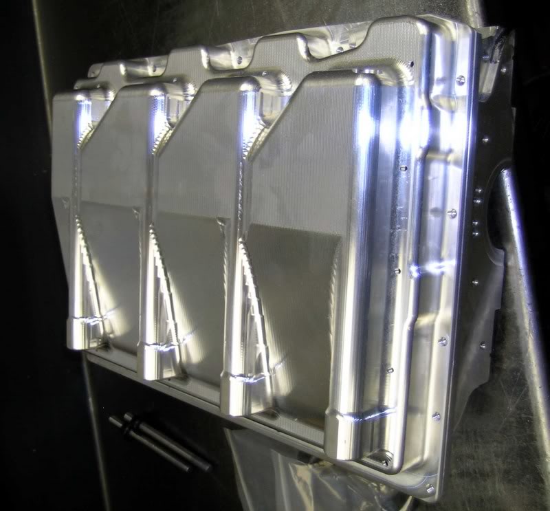

Hey, Charlie over at Weston Machine has produce a handful of these already...
www.westonmachine.com

It's a complete system with external pump - Just give Charlie a call at Weston Machine and tell him Phil Petracca posted some pics of his VQ35 girdle drysump system and he'll provide you with all the details...

The girdle and pan alone are $4500, not to mention the extensive machine work required. Then you add things such as the pump for ~1000, reservoir, lines, etc and you approach the 10k mark.

yep - big money... I'm not running it on my setup, complete overkill on my power levels... There are a few pro teams running it though, and their power levels were over 1700whp last time I checked in... The problem that was reported at those levels was related to the block splitting in half like a wish bone
