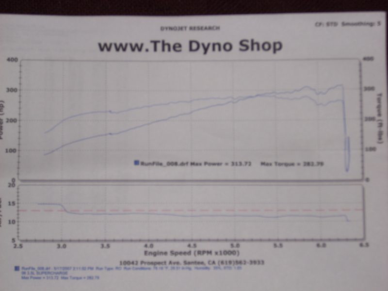

And Finally, Dyno:
I extrapolated based on my butt dyno.
Real Dyno:
313.72 HP and 282.79TQ
Click for more pics and some clips

Edit: Why do you stop at 6300rpm?
Thanks. Means alot coming from a Mod.
Why the stop at 6300, that's a question for Scott. Not sure.
Thanks Stan, you and your roadster were awesome to work with. I am pretty sure that the rev limiter or top speed limiter was the deciding factor in the 6300 RPM ending, nothing that a re-flash wouldn't take care of , or while we are at it why not add some 3.91 final drive gears, and the 3.12 pulley ??? But enjoy your car how it is............(for now) .......

I was thinking that the power was a bit low as well.

The power may seem a little low, but I'm really as happy as can be.

3- power on the 7psi should be at least 320-330rwhp
4- grats and welcome to vortech!
1 - I'm guessing the BOV needs to be tighter due to the lower amount of boost.
2 - Relentless will adjust next time I'm there if I want to.
3 - Not on 7PSI, running 5ishPSI because of the entire tubing of the car is 1/2" larger.
