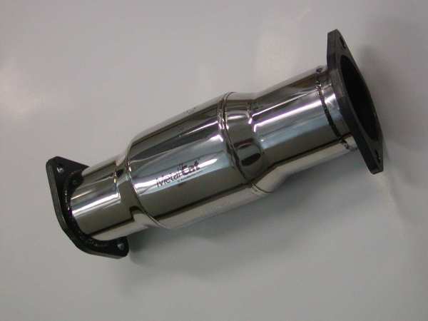

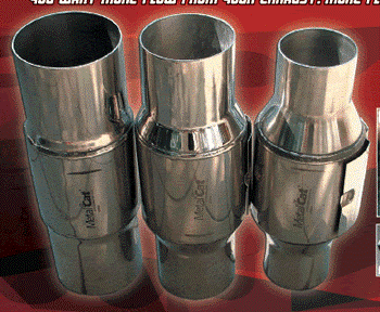

This is what I'm thinking. Downpipe to a 3.5" then a universal 3.5" 200 cell psi spun metal catalytic converter. You think this would do the trick? Or use a 100 cell ?
Here are some universals I found searching Google. Metal'cat so far seems to be the best and makes up to a 3.5" cat.

Attached Thumbnails 3.5" custom FI catalytic converters-metalcat-lineup.gif   3.5" custom FI catalytic converters-metalcatboltonfornissanlowerres_001.jpg
