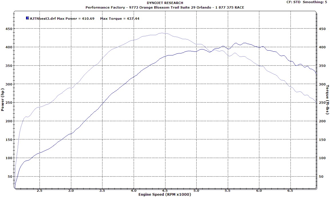

btw this is what happens with a Tial 44 mil WG and an open dump, 11.5 quarter mile times with this kinda power on a stock block...
