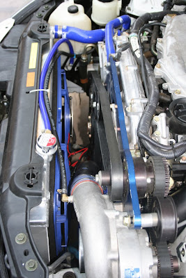

Will those fans only fit with that AMS radiator, or are they universal? I'd like to look into something like that...

They are universal. I went with them because they are thinner than stock. With the AMS radiator and Vortech, I ran into problems with space.

Yeah, I am having to go with the thinner Koyo radiator due to fitment issues with the turbonetics kit. I'm wondering if it would have been a better use of money to just go with that and the thicker one... hmm...

The AMS is about 50mm or so. With the FAL and the AMS, I was still able to clear everything with the Vortech. I'm pretty sure this setup is actually thinner than the stock rad and fan setup. I'll try to take some measurements.

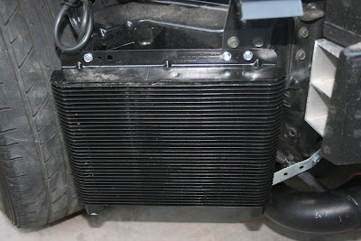

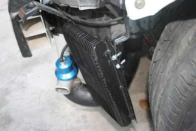

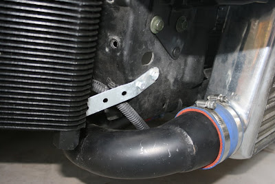

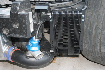

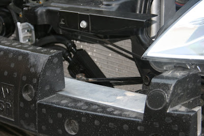

Link to all pics:
http://picasaweb.google.com/istan350...ey=EqvPZmfXM00
Spacing between Vortech, AMS, and FAL Fans
Powersteering
Oil Cooler
Oil Cooler again
Tranny Cooler (removed windshield wiper resevoir)
Tranny Cooler reinforment bracket
