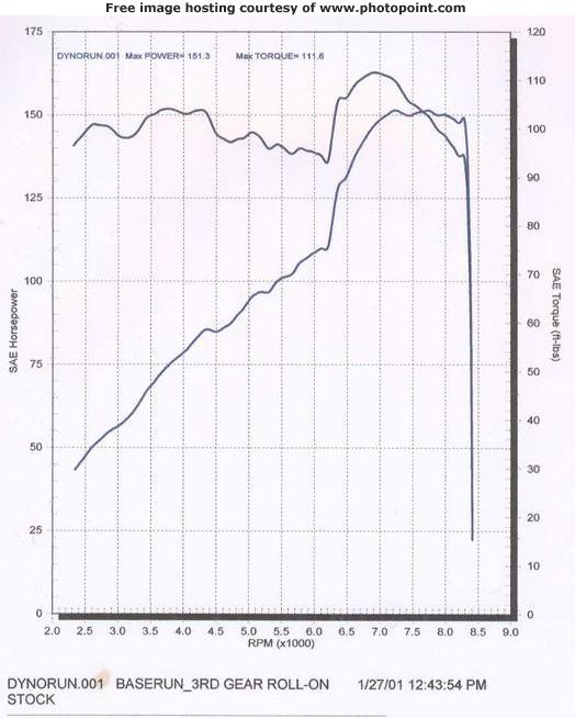

Originally Posted by BigBodySmith
when vtec pops, it still should be linear, not a jump like that...
yeah sometimes, sometimes not
here's a celica dyno, yeah technically not "vtec" but same thing only toyota's version

Originally Posted by sentry65
hehe, just don't tell that to the guys that say the lag is a non-issue
even at 5000+ rpms launches
OT-but VVTL-I (Toyota-think GTS 2ZZ)) is similar to I-VTEC (K series) technology found on newer Hondas, they have intake AND exhaust cam timing as opposed to just intake cam timing on old VTEC cars (B, H series). Some do have that jump, some are linear, so bigbody isnt neccessarily correct in his post above.
