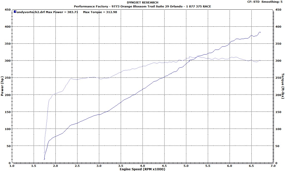

change over to the 3.12 pulley and retune it, it should look like this...
Attached Thumbnails Vortech Tuning blues....w/Dyno chart and video-andy-vortech.jpg

Ive logged boost after a tight belt will not hold any more . But never a loose belt . That boost graph looks pretty smooth and I guess that may be because of the smoothing from the Dyno ???? WHat I've logged was more up/down up/down .
